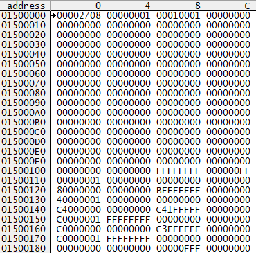

I have enabled TZC400 registers and Region as shown below in the memory dump for LS1046ARDB.
I have configured the security attributes for DRAM Region 1, spanning from memory address 0x80000000 to 0xBFFFFFFF, with the intention of allowing secure read-only access. However, I have encountered an unexpected behavior: I am able to write data to the memory location 0x80000000, which should be restricted due to the read-only setting.
Could you please suggest me where and what should be done in this case so that I should be restricted access to secure write to this region?

Hello Khushbu,
I have Followed below steps:
i) Initialized base address of TZC400 as 0x01500000
ii) created a pointer to TZC_Regions structure(Above snapshot of memory dump has the details of this registers)
iii) Disabled Filters
iii) Region 0 is set to no access
iv) Configure other regions as per the TZC_Region structure(Above snapshot of memory dump has the details of this registers)
v) set action register
vi) Enabled Filters
Next I am calling this all functionality in main function
Later I am trying to write any random value and instead of restricting secure write access to region from 0x80000000 it is allowing me to write .
I dont know the issue , If you want me to send you the used Code , I can reply you in Service case you have created.
