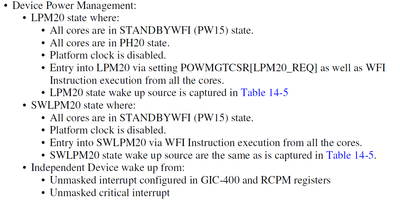

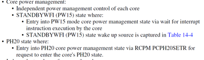

Hi NXP,
Can I have a list of the power management and performance related features of the LS1043A that I can adjust/control? I have attached a QorIQ Power Management white paper, is this up-to-date?

Please refer to "14.1.3 Power Management Features" in LS1043ARM.pdf for details.
