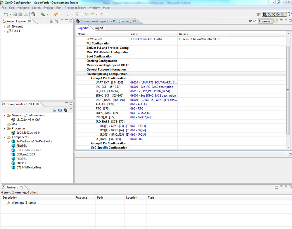

Does the QorIQ family have any Pin Mux tool that allows pin configuration of LS1021A processor?
I have searched but could not find it for QorIQ family.
If no, what would be the best possible way to go ahead. Thanks!!

From the QCVS project wizard, you should select Pin Muxing Configuration, like below:
After that, you have to select the PinMux component:

If you select QCVS to be installed from the install wizard you should see something as below:
If don't see the QorIQ Configuration Project, go to Help > Install New Software and use ARMv7 Main Updater Site to install QCVS
Make sure during installation now ccs.exe or cdde.exe are present in Task Manager.
Adrian

deepaknaiknavar
Thanks Adrian !!
I have reached untill here. Here, i see Pin Multiplexing option but it does not have complete pins.
Is it correct?
4,204 Views
addiyi
Please refer to www.nxp.com/qcvs. QCVS provides Pin Muxing Configuration tool for LS devices.

Hi Adrian !
I have installed codewarrior for arm 7 (QorIQ) Ver 10.0.8.
But i cannot find QCVS option. Is there any help to access QCVS pin mapping tool?

deepaknaiknavar
Thanks a lot !! It looks this will solve the Problem..
