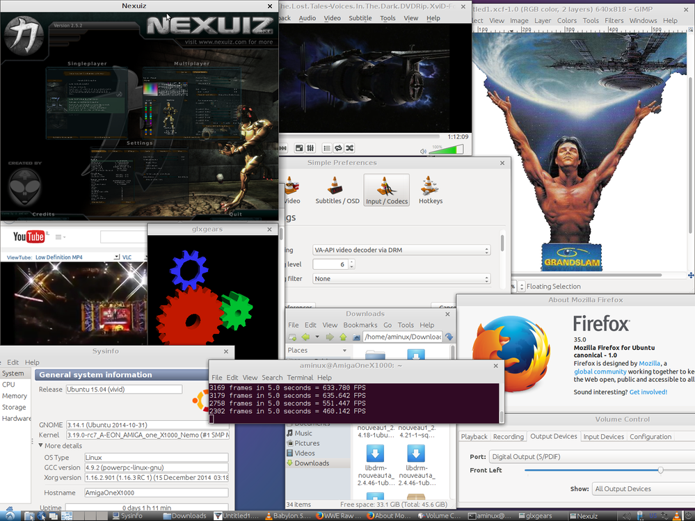

Hi All,
We're testing the development version of Ubuntu 15.04 on our AMIGA PowerPC computers. Here are some screenshots:
Lubuntu 15.04 PowerPC (AMIGA one X1000):

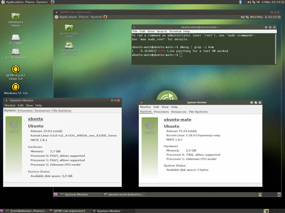

ubuntu MATE 15.04 PowerPC (AMIGA one X1000):

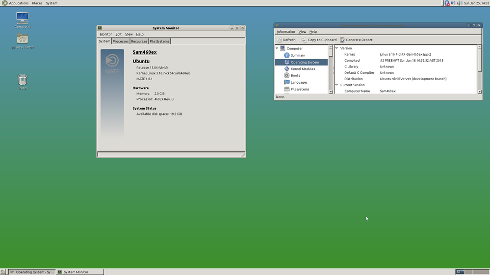

Lubuntu 15.04 PowerPC with MATE desktop (Sam460ex):
