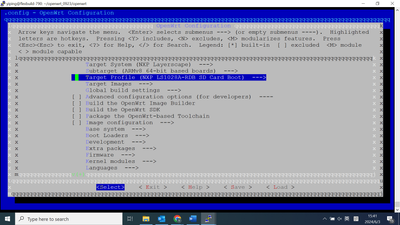

Please remove ".config", then run "make menuconfig" and configure the menu as the following.
Please configure Target Profile as (NXP LS1028A-RDB SD Card Boot), then run make to build image.
3,402 Views

It appears that the SD boot image does not contain the PBL and U-Boot, whereas the flash image has the correct files. I have examined both images in the U-Boot environment as follows:
Size:
1) *sdboot.img.gz:12MB
2) *firmware.bin:28MB

yipingwang
gzip -d openwrt-ls1028a-rdb-sdboot-full.img.gz
