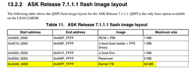

I have used the following link to create my fitimage.itb file for a ls1012ardb development board: https://github.com/nxp-qoriq/yocto-sdk.
I have followed the instructions and compiled using:
. ./setup-env -m ls1012ardb
bitbake fsl-image-kernelitb
the above throws me -> build_ls1012ardb/tmp/deploy/images/ls1012ardb/kernel-fsl-ls1012a-rdb-20230803143154.itb
according to the documentation I am loading the image in the qspi NOR flash in bank#2
setenv ipaddr 192.168.2.236
setenv serverip 192.168.2.254
tftp 0xa0000000 kernel-fsl-ls1012a-rdb-20230803143154.itb
sf probe 0:0
;;sf erase 0xa00000 +$filesize
sf erase 0xa00000 0x3600000
sf write a0000000 0xa00000 $filesize
* bootargs=console=ttyS0,115200 root=/dev/ram0 earlycon=uart8250,mmio,0x21c0500
* bootcmd=pfe stop; sf probe 0:0; sf read $kernel_load $kernel_start $kernel_size && bootm $kernel_load#ls1012ardb
* kernel_load=0xa0000000
* kernel_size=0x2800000
* kernel_start=0xa00000

I have the same result if a try to load the individual images generates by yocto "uImage", "mfgtool-ls1012ardb.rootfs.cpio.gz.u-boot" and "ls1012arrb.dtb" in RAM or the image.itb from RAM memory.
tftp a0000000 kernel-fsl-ls1012a-rdb-20230803143154.itb
bootm a0000000
or
tftp a2100000 uImage
tftp a5300000 mfgtool-ls1012ardb.rootfs.cpio.gz.u-boot
tftp a8500000 ls1012arrb.dtb
bootm a2100000 a5300000 a8500000
am I doing something wrong? could you guide me please? thank you.
1,686 Views
khushbur
Hi @Jesus92
Can you please flash PPA FIT and PFE firmware image as shown below.
tftp 0xa0000000 ls1012ardb-ppa-ls1012a_8.0.0.B1.itb
tftp 0xa0000000 pfe-ls1012a_8.0.0.B1.itb
Khushbu
