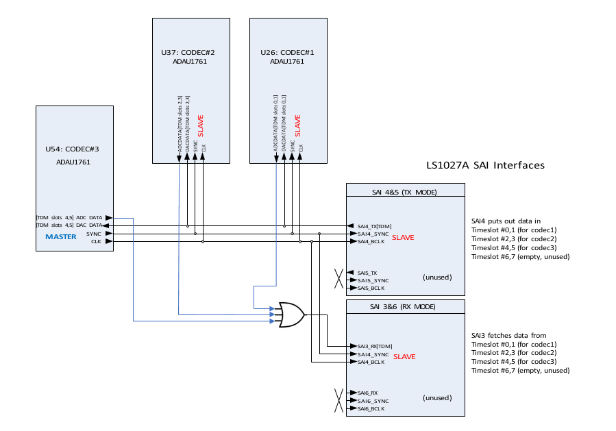

I am working on bringup of a custom board with a LS1028A and three ADAU1761 codecs. The codecs are supposed to be configured in TDM8 mode and share a common playback I2S bus connected to SAI4, and a common capture I2S bus connected to SAI3.
What is the recommended way of modelling this setup in the Linux device tree ?

At first I attempted creating three simple-audio-card's. That attempted failed since sharing the same cpu (SAI3 and SAI4) failed with no ALSA device as a result.
Then I attempted cerating a single simple-audio-card with a dai-link containing two cpu sub-nodes and three codec sub-nodes. ALSA enumerates this device, and I get the expected ADAU1761 controls for a single codec. But how do I get the two other sets of ADAU1761 controls? And how do I do the widgets and routing for this ?

Can you please share the block diagram or connection diagram of your board, which can show the audio data flow between source and sink.
8,018 Views
rpk
Attached is a connection diagram of our board.
Rolf
8,018 Views
yipingwang
We don't have a such set up with multiple codecs, so we can suggest you some experiments to work with -
1) As per our understanding either SAI or codec can be the master device for bit clock and frame clock.
So if codec@0 is set as master then SAI (cpu) can’t be set as master it should be slave device.

Your block diagram depicts U54 Codec #3 as the master, so make sure you populate  these values correctly.
2) Can you also try with multiple dai-link nodes, one for each codec I am referring to Documentation/devicetree/bindings/sound/simple-card.txt, Example #2, where both dai-link@1 and dai-link@2 have same cpu  subnode  but different codec node.
