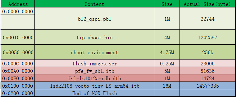

With my custom board, a 32M NOR flash is used. I want to change the layout.
LS1012ARDB flash layout
Below is my expected NOR flash layout:
After I erase the NOR Flash and burn the images, System can't enter into uboot, it stops at PBL stage, Could you help to tell me what I should do to change my flash layout?

I see in your expected NOR flash layout that the actual size for u-boot environment is 262,144 but the size of memory for u-boot is only 256k, you also said that you modify lsdk2108_yocto_tiny_LS_arm64.itb to make it smaller and It works fine, Where did you test it?

Hugh512
Thank you, Oswalag.
Uboot has at least 1M size, but I made a mistake, only reserved only 1M, After I reserved 1.5M, the start address of uboot environment changed to 0x280000, it works.

Hugh512
LS1012ARDB default NOR Flash Size is 64M, My custom board NOR Flash size is 32M, I modifiy lsdk2108_yocto_tiny_LS_arm64.itb to make it smaller. It works fine. After I relocated the pfe_fw_sbl.itb to 0x001C 0000(256K size) in NOR Flash, It's not work.
