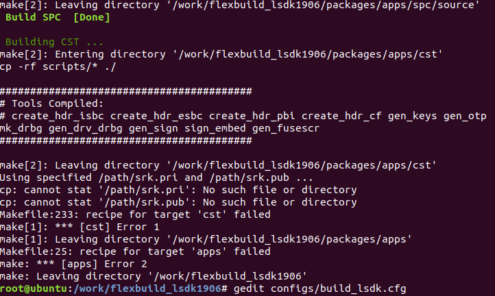

Hello
I am getting an error when compiling Edgescale firmware using LSDK1906. Executing ‘flex-builder -m ls1046ardb -a arm64’ can be done before opening Edgescale.
However, after opening Edgescale, the operation of ‘flex-builder -m ls1046ardb -a arm64’ will cause an error. The specific operations are as follows:
1,gedit configs/build_lsdk.cfg :
         CONFIG_APP_EDGESCALE=n   ------>   CONFIG_APP_EDGESCALE=y
         #SECURE_PRI_KEY=/path/srk.pri  ------->  SECURE_PRI_KEY=/path/srk.pri
         #SECURE_PUB_KEY=/path/srk.pub -------> SECURE_PUB_KEY=/path/srk.pub
2,flex-builder clean
3,flex-builder -m ls1046ardb -a arm64
error:
Building SPC ...
make[2]: Entering directory '/work/flexbuild_lsdk1906/packages/apps/spc/source'
make[2]: Nothing to be done for 'default'.
make[2]: Leaving directory '/work/flexbuild_lsdk1906/packages/apps/spc/source'
Build SPC [Done]
Building CST ...
make[2]: Entering directory '/work/flexbuild_lsdk1906/packages/apps/cst'
cp -rf scripts/* ./
# Tools Compiled:
# create_hdr_isbc create_hdr_esbc create_hdr_pbi create_hdr_cf gen_keys gen_otpmk_drbg gen_drv_drbg gen_sign sign_embed gen_fusescr
make[2]: Leaving directory '/work/flexbuild_lsdk1906/packages/apps/cst'
Using specified /path/srk.pri and /path/srk.pub ...
cp: cannot stat '/path/srk.pri': No such file or directory
cp: cannot stat '/path/srk.pub': No such file or directory
Makefile:233: recipe for target 'cst' failed
make[1]: *** [cst] Error 1
make[1]: Leaving directory '/work/flexbuild_lsdk1906/packages/apps'
Makefile:25: recipe for target 'apps' failed
make: *** [apps] Error 2
make: Leaving directory '/work/flexbuild_lsdk1906'
root@ubuntu:/work/flexbuild_lsdk1906#
Can you advise me what to do next?

Hello Peng Luo,
There is no valid srk.pri and srk.pub key pairs in /path folder.
You could go to cst folder, then generate srk.pri and srk.pub key pairs, then copy them to a specified path.
Please refer to the following example.
$ cd  ~/flexbuild_lsdk1906/packages/apps/cst
$ ./gen_keys 1024
$ cp /home/yiping/flexbuild_lsdk1906/packages/apps/cst/srk.pri  ~/flexbuild_lsdk1906
$ cp /home/yiping/flexbuild_lsdk1906/packages/apps/cst/srk.pub  ~/flexbuild_lsdk1906
Then modify configs/build_lsdk.cfg as the following
SECURE_PRI_KEY=//home/yiping/flexbuild_lsdk1906/srk.pri
SECURE_PUB_KEY=//home/yiping/flexbuild_lsdk1906/srk.pub
Then execute flex-builder command
$ flex-builder -c cst -m  ls1046ardb
$ flex-builder -m ls1046ardb -a arm64
Yiping
