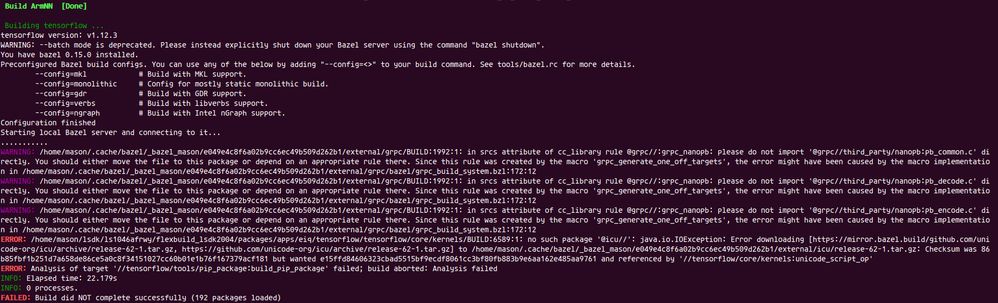

How to build tensorflow without error with LSDK 20.04?
flex-builder docker
source setup.env
flex-builder -c tensorflow
WARNING: /root/.cache/bazel/_bazel_root/e049e4c8f6a02b9cc6ec49b509d262b1/external/grpc/BUILD:1992:1: in srcs attribute of cc_library rule @grpc//:grpc_nanopb: please do not import '@grpc//third_party/nanopb:pb_common.c' directly. You should either move the file to this package or depend on an appropriate rule there. Since this rule was created by the macro 'grpc_generate_one_off_targets', the error might have been caused by the macro implementation in /root/.cache/bazel/_bazel_root/e049e4c8f6a02b9cc6ec49b509d262b1/external/grpc/bazel/grpc_build_system.bzl:172:12
WARNING: /root/.cache/bazel/_bazel_root/e049e4c8f6a02b9cc6ec49b509d262b1/external/grpc/BUILD:1992:1: in srcs attribute of cc_library rule @grpc//:grpc_nanopb: please do not import '@grpc//third_party/nanopb:pb_decode.c' directly. You should either move the file to this package or depend on an appropriate rule there. Since this rule was created by the macro 'grpc_generate_one_off_targets', the error might have been caused by the macro implementation in /root/.cache/bazel/_bazel_root/e049e4c8f6a02b9cc6ec49b509d262b1/external/grpc/bazel/grpc_build_system.bzl:172:12
WARNING: /root/.cache/bazel/_bazel_root/e049e4c8f6a02b9cc6ec49b509d262b1/external/grpc/BUILD:1992:1: in srcs attribute of cc_library rule @grpc//:grpc_nanopb: please do not import '@grpc//third_party/nanopb:pb_encode.c' directly. You should either move the file to this package or depend on an appropriate rule there. Since this rule was created by the macro 'grpc_generate_one_off_targets', the error might have been caused by the macro implementation in /root/.cache/bazel/_bazel_root/e049e4c8f6a02b9cc6ec49b509d262b1/external/grpc/bazel/grpc_build_system.bzl:172:12
ERROR: /home/mason/lsdk/ls1046afrwy/flexbuild_lsdk2004/packages/apps/eiq/tensorflow/tensorflow/tools/pip_package/BUILD:132:1: no such package '@icu//': java.io.IOException: Error downloading [https://mirror.bazel.build/github.com/unicode-org/icu/archive/release-62-1.tar.gz, https://github.com/unicode-org/icu/archive/release-62-1.tar.gz] to /root/.cache/bazel/_bazel_root/e049e4c8f6a02b9cc6ec49b509d262b1/external/icu/release-62-1.tar.gz: Checksum was 86b85fbf1b251d7a658de86ce5a0c8f34151027cc60b01e1b76f167379acf181 but wanted e15ffd84606323cbad5515bf9ecdf8061cc3bf80fb883b9e6aa162e485aa9761 and referenced by '//tensorflow/tools/pip_package:licenses'
ERROR: Analysis of target '//tensorflow/tools/pip_package:build_pip_package' failed; build aborted: no such package '@icu//': java.io.IOException: Error downloading [https://mirror.bazel.build/github.com/unicode-org/icu/archive/release-62-1.tar.gz, https://github.com/unicode-org/icu/archive/release-62-1.tar.gz] to /root/.cache/bazel/_bazel_root/e049e4c8f6a02b9cc6ec49b509d262b1/external/icu/release-62-1.tar.gz: Checksum was 86b85fbf1b251d7a658de86ce5a0c8f34151027cc60b01e1b76f167379acf181 but wanted e15ffd84606323cbad5515bf9ecdf8061cc3bf80fb883b9e6aa162e485aa9761
INFO: Elapsed time: 41.850s
INFO: 0 processes.
FAILED: Build did NOT complete successfully (192 packages loaded)

Just find why tensorflow is failing to compile.
Package signature is wrong in
./sources/poky/meta/recipes-vmais/tensorflow/tensorflow_1.13.1.bb
This file points to this repository
git://github.com/tensorflow/tensorflow.git;branch=r1.13
Inside this repository , the file tensorflow/third_party/icu/workspace.bzl
def repo():
third_party_http_archive(
name = "icu",
strip_prefix = "icu-release-62-1",
sha256 = "e15ffd84606323cbad5515bf9ecdf8061cc3bf80fb883b9e6aa162e485aa9761",
urls = [
"https://mirror.bazel.build/github.com/unicode-org/icu/archive/release-62-1.tar.gz", URL DOES NOT EXIST
"https://github.com/unicode-org/icu/archive/release-62-1.tar.gz", THIS ONE HAS DIFFERENT SHA256 SIGNATURE.
build_file = "//third_party/icu:BUILD.bazel",
system_build_file = "//third_party/icu:BUILD.system",
patch_file = clean_dep("//third_party/icu:udata.patch"),
I am checking that branch r1.15 has the right file and the right signature.
