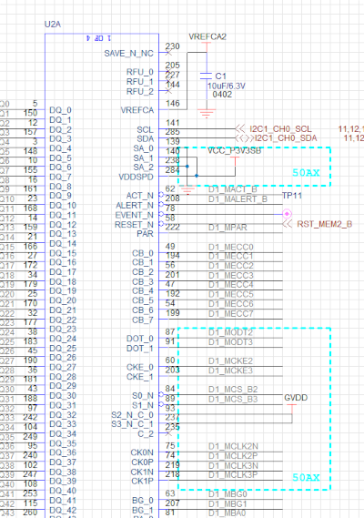

What does the comment "50AX" means on the LS2088A reference design board schematic at the DDR4 memory connection sheet?

"50AX" means board revision where corrections marked in the schematics were made.
