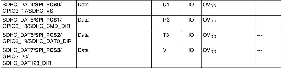

I want to run 8 bus witdh eMMC on custom LS1088 based board. I have successfully activated emmc, but it is inited as 4 bus width every time. According to what I see in the datasheet and reference design, I need to configure the pins that are SPI by default in the OVDD section as SDHC_DAT4-7 in the HS Mux. I tried to do this on the DTS side but I am getting a syntax error.

			LS1088A_SIGNAL(PAD_U1, SDHC_DATA4, 0x06000049) /* SDHC_DATA4 */
			LS1088A_SIGNAL(PAD_R3, SDHC_DATA5, 0x06000049) /* SDHC_DATA5 */
			LS1088A_SIGNAL(PAD_T3, SDHC_DATA6, 0x06000049) /* SDHC_DATA6 */
			LS1088A_SIGNAL(PAD_V1, SDHC_DATA7, 0x06000049) /* SDHC_DATA7 */

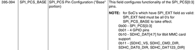

I solved the problem. In the RCW file, it was necessary to activate the function for emmc from the SPI_PCS pin settings.
SPI_PCS_BASE=2
