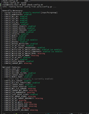

Based on the LSDK 2108  and also prevoius one i am not able to build properly docker and run it on image.
Based on ubuntu i do not have any problems.
Based on yocto devel - i am adding to the image proper meta's and build os properly. When i write it on sd card the os is booting properly i am in the netwotk but run docker is not possible.
Logs from dockerd:
root@DevelLinux:~# dockerd

failed to start daemon: Error initializing network controller: Error creating default "bridge" network: Failed to program NAT chain: Failed to inject DOCKER in PREROUTING chain: iptables failed: iptables --wait -t nat -A PREROUTING -m addrtype --dst-type LOCAL -j DOCKER: iptables v1.8.4 (legacy): Couldn't load match `addrtype':No such file or directory
Try `iptables -h' or 'iptables --help' for more information.
(exit status 2)

How to configure kernel?
I see that from meta-virtualization there are some kernel configs enabled.

yipingwang
It seems that there is problem with Linux Kernel configuration.
Please run the following script on your target board, then configure and rebuild your Linux kernel as it suggests.
https://github.com/moby/moby/blob/master/contrib/check-config.sh
