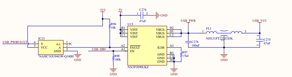

We have a LS1046A based board, it includes one USB 2.0 plug on which we try to connect a USB stick, without success so far.
After investigating it seems that the USB_DRVVBUS signal never goes high, thus preventing the 5V (USB_VCC) from reaching the USB stick. Messing around with the RCW we managed to set this signal as GPIO and to force it up which brought the 5V to the USB plug, thus validating the "usb power circuitry" on U15, but still no device is detected regardless if it's powered or not.
Schematic for USB plug side:
Schematic for LS1046A side :

USBx_PWRFAULT,USB_DRVVBUS,USBx_PWRFAULT.
Check the three signal include rcw config and checklist requirment.

Checking the schematics, USBx_RX_P and USBx_RX_M should be grounded. I enclosed the design check-list for LS1046A. Check the Table 4 for USB power supply filter circuits.
I do not know what could be the cause "My software guy had to remove erratum_a009007 inside the soc.c (from uboot or the linux distro, not sure about that one) system wouldn't boot otherwise.". From the Dermiste_3, all USB power is connected. Can you confirm all these USB supplies are powered up when A-009007 workaround is implemented. Having said that, you do not need A-009007 as USB 3.0 is not implemented on your system.

Yes I am aware that RX_P & RX_M should be grounded, which is not implemented on my schematic.
