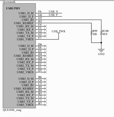

Schematic for USB plug side:
Schematic for LS1046A side :

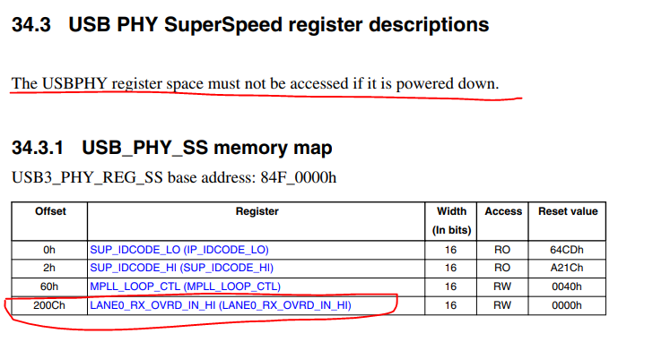

  • My software guy had to remove erratum_a009007 inside the soc.c (from uboot or the linux distro, not sure about that one) system wouldn't boot otherwise. That erratum is linked to USB3 configuration, doc says no write in the linked registers should happen if USB core is powered downDermiste_4-1685609657903.pngDermiste_4-1685609657903.png

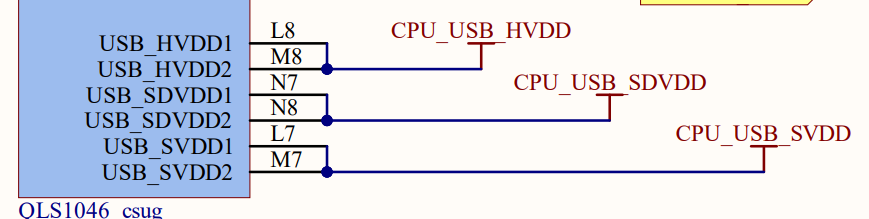

  • USB power rails OK, they all go up within a 17ms delay:Dermiste_3-1685608460319.pngDermiste_3-1685608460319.png

Checking the schematics, USBx_RX_P and USBx_RX_M should be grounded. I enclosed the design check-list for LS1046A. Check the Table 4 for USB power supply filter circuits.
I do not know what could be the cause "My software guy had to remove erratum_a009007 inside the soc.c (from uboot or the linux distro, not sure about that one) system wouldn't boot otherwise.". From the Dermiste_3, all USB power is connected. Can you confirm all these USB supplies are powered up when A-009007 workaround is implemented. Having said that, you do not need A-009007 as USB 3.0 is not implemented on your system.
Yes, you can debug this issue entirely under uboot. Actually, it is easier to do it under uboot.
As long as all the 3 USB power supplies are provided, the USB core should be properly powered. The USB clock can use either single ended or differential clock Sysclock. However, it has to be 100 MHz.

Yes I am aware that RX_P & RX_M should be grounded, which is not implemented on my schematic.
I can confirm that the USB power goes up within 17ms after CPU_VDD goes up, I assume  that when soc.c is executed USB cores are therefore powered.
I am not sure however if the USB core is not damaged and at this point I'm interested in seeing how I can debug this from uboot, if the core is damanged or not powered it means I won't be able to write any register linked to USB PHY, correct? Writting reg using rw should therefore not work?
