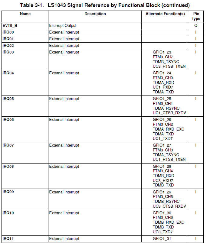

Hello everyone,
I found out thanks to the document QorIQ LS1043A Reference Manual, Rev. 6, 07/2020, that the ls1043a processor has the following list of external interrupt input signals:
These interrupt input signals are connected to the Arm generic interrupt controller (GIC-400).
I wanted to know if there was a concept of priority over interrupts among these interrupt input signals.
If priority is present, is the priority of these interrupts programmable?

The priority of these interrupts can be set using Interrupt Priority Registers. Refer Table 3-2 Distributor register summary  in GIC-400 Technical Reference Manual ( https://developer.arm.com/documentation/ddi0471/b). Also refer ARM Generic Interrupt Controller Architecture Specification for Priority registers.
