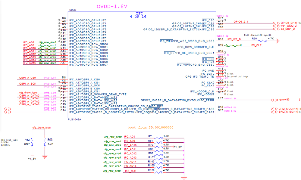

I hope somebody can help me to check the unconnected pins,I am not sure whether they meet POR configurations。 Thanks!!

Everything looks ok with POR configuration: SD boot, DDR4 memory, differential SYSCLK.
