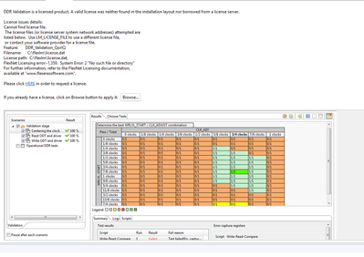

Hi, I am trying to validate the RAM on a LS1043A board. I am trying to use the DDR Validation tool inside CodeWarrior Development Studio for QorIQ, but it is saying I need a license.
Is there an evaluation license available?

Yes, there is.
We have an evaluation license for 15 days.
Here is the link to generate your CodeWarrior QCVS License:
https://www.nxp.com/company/about-nxp/smarter-world-videos/HOW-TO-GENERATE-YOUR-LICENSE-VID
