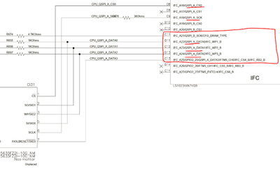

Good afternoon, we are using an u-boot for ls1043 in QSPI with our custom board but if we read from address 0x7fb00000 where we have our cpld, the value read is always 0xff:
=> md.b 0x7fb00000 1
7fb00000: ff .
7fb00000: ff .
=> md.b 0x7fb00000 2
7fb00000: ff ff
We verify all configurations and we did many tests since many weaks ago. If possible, with your experience, could you review quickly our IFC configurations in attached files.
Thank you

Hello, if NXP can review, we send now the IFC connections (see also the image) and the RCW file/binary.
IFC_A22 ... IFC_A25 -> DATA0 to DATA3
IFC_A16 -> QSPI_A_CS0
IFC_A18 -> QSPI_A_SCK
29,780 Views
ufedor
In the provided "rcw_ac16_qspi.bin" RCW[IFC_MODE] is set to 0b001000100.
Please consider that in the QorIQ LS1043A Reference Manual, Table 4-9. RCW source encodings there is note 1 for cfg_rcw_src 0_0100_010x saying:
"Not valid as an RCW[IFC_MODE] encoding"
It is needed to correct the RCW[IFC_MODE] to contain a valid cfg_rcw_src value from the Table 4-9.

ufedor
What cfg_rcw_src is used for booting from NAND?
In the provided U-Boot log the IFC_MODE value is 0b000100101 - i.e. 16-bit NOR Flash, address shift left by 4, AVD before CS.
