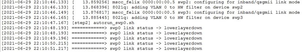

pjw
Thanks for your reply.
As you told us, we conducted the test using "enetc_swtich_cpu_port_without_bridge_dsa.sh".
Create the 'autorun_swp0.sh' file to proceed automatically.
I registered on ".bashrc" as below.
./enetc_swtich_cpu_port_without_bridge_dsa.sh
sleep 1
./autorun_swp0.sh
The contents of the autorun_swp0.sh file are as follows.
#! /bin/bash
ipaddr=192.168.0.252
ping_addr=192.168.0.1
port=swp0
ip addr add $ipaddr/24 dev $port
sleep 1
# ping test
status=($(cat /sys/bus/pci/devices/0000:00:00.5/net/$port/operstate))
echo "============> "$port" link status ->" $status
while [ $status != up ]; do
  sleep 1
done
ping -c 60 ${ping_addr}
ifconfig $port down
sleep 1
ifconfig eno2 down
sleep 1
reboot
After approximately 60 repetitions, the message "swp0 link status -> lowerlayerdown" was printed.
For verification, I attach the log file.
