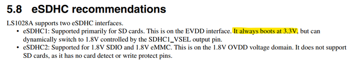

We have developed a custom board with the LS1027A, but we can't get it to boot with the SD Card.
The LS1027A is set to 1.8V at the EVDD pin, meaning the SDIO interface is always at 1.8V, unlike the NXP dev kit, which is set to 3.3V. Then, in our board, we have a 1.8V/3.3V level translator to interface with the SD card, but that should be transparent to the LS1027A.
We can see activity in and out from the SD card, but the boot stops at some point.
Is the LS1027A able to reliably boot from SD card when the interface is at 1.8V?
The question comes from the recommendation below, taken from AN12028.
 Best regards.

Please refer design checklist AN12028, Table 23
For UHS mode, voltage switching is required from 3.3V to 1.8V
The SDIO expander you have used cannot support voltage switching as it supports two SD cards at a time and one may not be ready to switch to UHS.
There are voltage translators that can help to achieve the voltage switching.
LS1027A SDHC controller also supports voltage switching without requiring the in between voltage translator.
EVDD power rail can switch from 3.3V to 1.8V. You may refer NXP reference design for reference.

SDHC specification requires all SD interfaces to come up at 3.3V at power and run at default speed.
When switching to UHS mode, voltage also should switch to 1.8V. The voltage translator on board should be capable of doing this voltage switching..
EVDD voltage rail can support both 3.3V and 1.8V. The way it has been designed is to switch to UHS mode without the need of an extra translator on board.
To answer your other question, it is possible to keep EVDD at 1.8V, add on board voltage translator and boot.
You need to share schematic snippet and more details to help us debug your system.
WHen you say boot problem, what fails? Is the RCW loading complete? Is the PBI complete?
Do you have a Code warrior tap? Can you connect it the board and dump the config chain?
