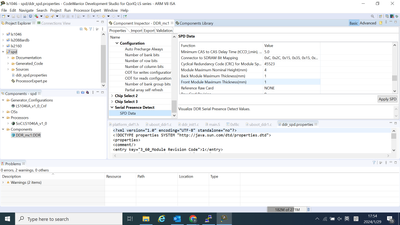

we have a custom board with an LS1046A and a DDR4 DIMM module.
I have extensively read the QCVS_DDR_User_Guide.pdf.
When I start QCVS and create a new QorIQ DDR validation project, I have the option to read the SPD. After I read the SPD, I get the green check mark. I go ahead and click FINISH.
Now when I go to the Component Explorer, and look at the DDR properties, I click on "SPD Data" and then on the "..."  Now, I expect to see the SPD data, but it is not populated (I get two empty boxes).  I do see a file "ddr_spd.properties" in the project folder, and when I open it, it appears to contain the SPD data in XML format. Lots and lots data in that file ...
I have followed all the steps as outlined in QCVS_DDR_User_Guide section 1.1.4.1, pages 22-25, but do not get the same behavior.
I am running Ubuntu 22.04, in case that matters.
Any pointers appreciated !

rudolfusselmann
Thank you for your message Yiping !
I am following these same steps as you are in your picture, but I do not understand how to make the SPD data move up.
Please see my attachment.
Many Thanks !
rudi

yipingwang
Please check whether you can continue to do validation in QCVS DDRv tool.

rudolfusselmann
Yes, I can continue, and we do get optimal settings.
I am wondering why the tool does not work for me as it supposed to ?

yipingwang
Please refer to my following screenshot captured when connecting CodeWarrior to LS1046ARDB.
Do you have LS1046ARDB? If yes, please connect your CodeWarrior to LS1046ARDB to do verification.
