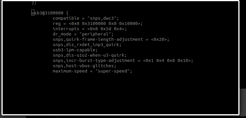

I am trying to make my standalone USB3.0 OTG works as a device mode ( my device has a type C male connector) here is my device tree file:
But it still not working, I can see my usb0 interface:

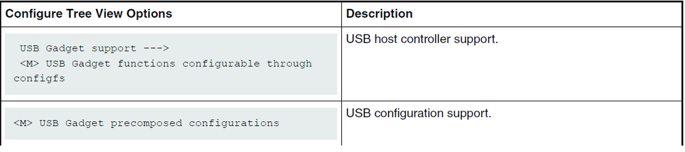

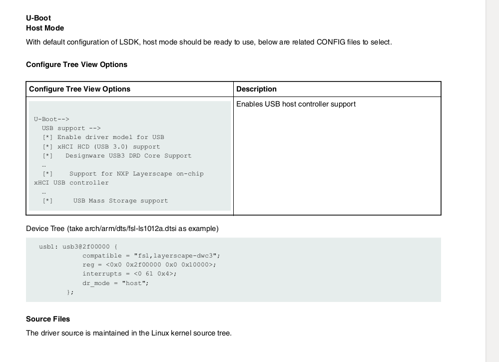

Then I saw this from lsdk1906
Then I enable necessary modules from the uboot kconfig for the USB3.0 ethernet device mode

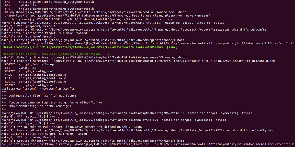

then I tried to recompile the uboot using
flex-builder -c uboot -m ls1021atwr -b sd
and I saw
Please help

Hello Elias Bitbaker,
Please refer to the following Linux Kernel and dts configuration.
Linux Kernel:
In the dts file, please change property dr_mode's data from "host" to "peripheral", add property maximum-speed = "super-speed".
usb3: usb3@3100000 {
compatible = "snps,dwc3";
reg = <0x0 0x3100000 0x0 0x10000>;
interrupts = <GIC_SPI 93 IRQ_TYPE_LEVEL_HIGH>;
dr_mode = "peripheral";
snps,quirk-frame-length-adjustment = <0x20>;
snps,dis_rxdet_inp3_quirk;
usb3-lpm-capable;
snps,dis-u1u2-when-u3-quirk;
snps,incr-burst-type-adjustment = <1>, <4>, <8>, <16>;
snps,host-vbus-glitches;
maximum-speed = “super-speed”;
