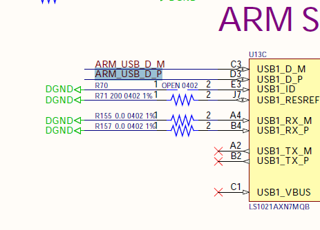

We have a LS1021A board based on the TWR board. Our board has a MCP2200 USB to Serial Coverted connected to USB1_D lines. I was trying to figure out how to get the linux kernel to create a tty device to communicate to an external serial port from the arm.
I tried enabling the ftdi_sio drivers using the CONFIG_USB_SERIAL_FTDI_SIO as well as enabling CONFIG_USB_SERIAL, and setting them to y so that they built in.
I also tried adding the following to the dtb. But no luck there either.

Finally works now. Two changes were needed.
RCW[SDHC] needs to be set to 1 (or anything but 3) because the PWR FAULT and DRV BUS has to be ignored since this chip has its own power.
RCW[USB3_CLK_FSEL] has to be set to 57 to enable clocks for USB3.

In the schematic should the USB1_VBUS be connected for the application above ? It appears to be connected on the TWR eval board. But that use case is different from this one.
Thank you,
Ram Krishnan

We found one issue in which the RCW[SDHC] should be set to anything non-usb1 since this device will have its own power. So we set that to 1 to make it all GPIO4 and now we see activity when we probe the D_M and D_P lines but the ttyACM0 is still not coming up.
On the uboot if we do start usb we get the following message
USB device not accepting new address (error=80000000)

ramkrishnan
Attached are the schematics for that chip
