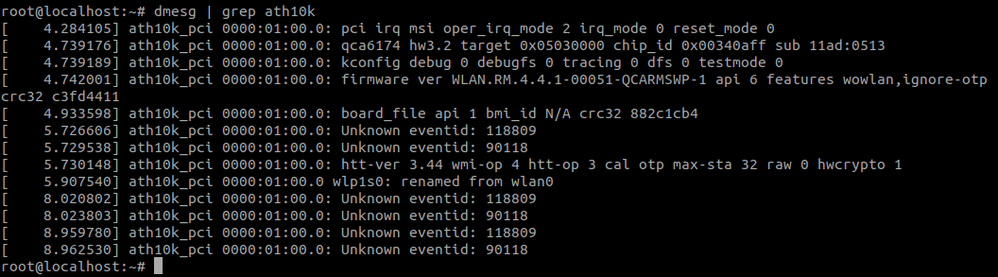

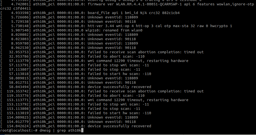

Anyone knows what's the issue here.
My kernel does have the interface up
But after I scan there are no wifi names showing up

This is a  device-specific problem, which, based on the provided screen
captures, is a result of device's failure to respond to certain commands.
This is totally the driver and underlying HW specific, thus the suggestion
is to approach your radio card manufacturer for more detailed error output
interpretation and troubleshooting.
