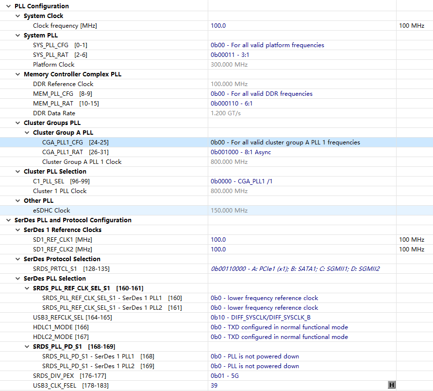

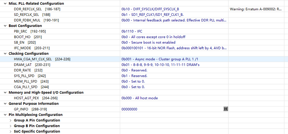

Now we are debugging boot of LS1020.
Chosen two single end@100M as SYSCLK and DDRCLK, the Boot is ok.
And want to use one Differential Clock@100M ,while use 4.7K resistor to pull IFC_WE0_B(cfg_eng_use0)down to GND. But LS1020 can not boot up.
Pls check the configu as below and the PBL in attached, and give some advise how to boot with Differential clock,TKs!
LS1020 Boot SYSCLK.pngLS1020 Boot SYSCLK.pngLS1020 Boot SYSCLK1.pngLS1020 Boot SYSCLK1.png
