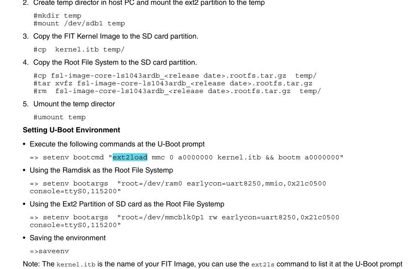

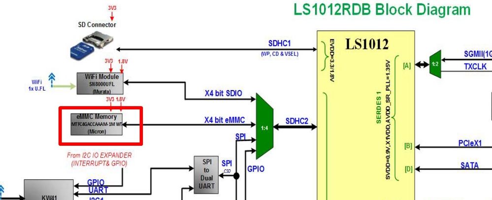

I can't mount EMMC Root File System.I refer to SDK 2.0 inittab entries not found booting from /dev/mmcblk0p2 and  QorIQ LS1012A BSP v0.5 Guide, but does not working.

=> printenv
baudrate=115200
boot_bank1=i2c mw 0x24 0x3 0xf4;reset
boot_bank2=i2c mw 0x24 0x7 0xfc; i2c mw 0x24 0x3 0xf5;reset
bootargs=root=/dev/mmcblk1 rw earlycon=uart8250,0x21c0500 console=ttyS0,115200
bootcmd=ext2load mmc 1 a0000000 kernel-ls1012ardb.itb && bootm a0000000
bootdelay=5

MMC: FSL_SDHC: 0, FSL_SDHC: 1
