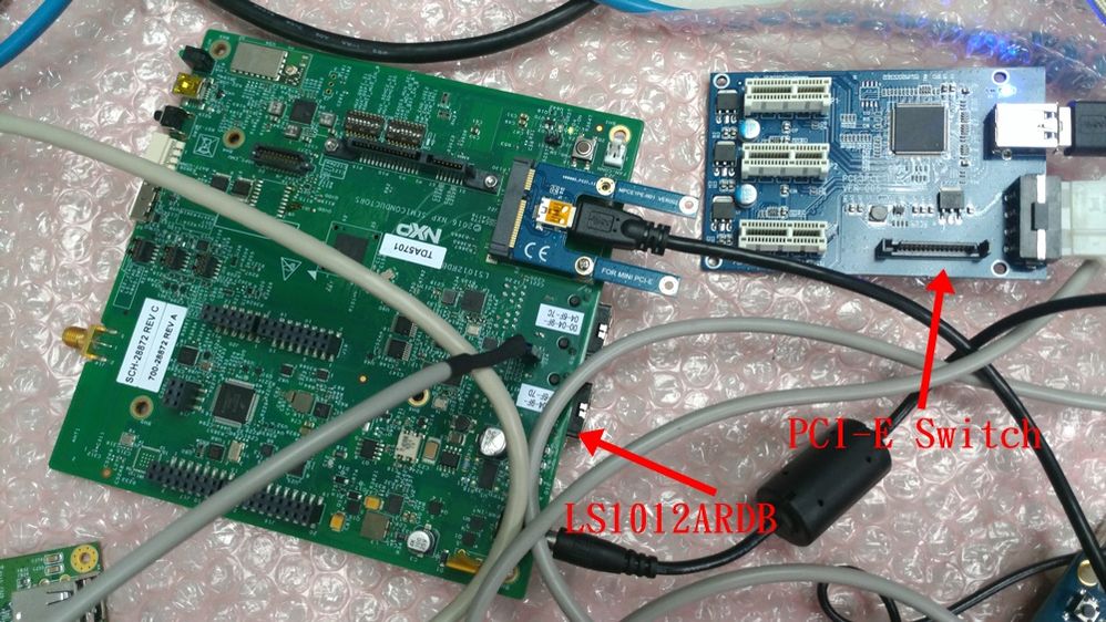

I installed the PI7C9X2G304SLBFDE PCI-E switch kit on LS1012ARDB, but sometimes it can't be detected PCI-E switch.
I would like to force it into Gen 1 mode for testing, how to modify the drivers and force Gen 1 mode?
Thank you.

Hello Jason Wu,
You could change Link_Control_2_Register[T_LS] register value to force link speed down to Gen1.
The offset of this register is 0xA0, PEX1 address is 0x3400000.
Under u-boot
=> md 0x34000a0 1
034000a0: 00010002                               ....
=> mw 0x34000a0 0x00010001
=> md 0x34000a0 1
034000a0: 00010001
