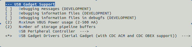

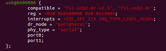

I am now in use the ls1021a-iot board. I wanted to use USB G_serial, modified the kernel and devicetree. But it had stopped during booting. Wondering take being done in order to use the g_serial?
     <kernel include Serial Gadget>
     <Devicetree>
