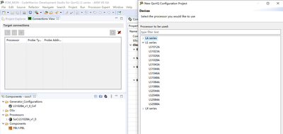

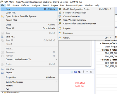

Hello, I am using the LS1017A processor and the CodeWarrior for ARM v8 2020.06 (CW ARM) software, but when I need to create a new BareBoard project, I find that there is no such option in CW ARM, as shown in the following figure:
In CodeWarrior for PowerPC 10.5.1 (CW PA), you can create a new BareBoard project:
Q1: How can I create a new BareBoard project to flash U-boot onto a new board?
There is another important issue, in CW ARM, it is not possible to select the LS1017 processor; only the following processor list is available:
Q2: How should I choose when using the LS1017A processor?

Please refer to section “3.2 Working with bareboard application” in C:\Freescale\CW4NET_v2020.06\CW_ARMv8\ARMv8\Help\Getting_Started_for_CW_ARMv8.pdf to create a bareboard project in CodeWarrior for ARMv8.
For flash programming, please refer to section "8.6 Board Recovery" in C:\Freescale\CW4NET_v2020.06\CW_ARMv8\ARMv8\Help\PDF\ARMv8_Targeting_Manual.pdf
