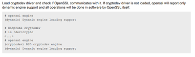

I am not getting the cryptodev engine in OPENSSL like below
Can you provide a neccessary details to fix this issue. Looking forward for your response.

This OpenSSL hardware offloading issue is due to linker path. I have updated the file: /etc/ld.so.conf.
By default, openssl through below error in LSDK_21.08
user@localhost:~$ openssl
openssl: symbol lookup error: openssl: undefined symbol: EVP_mdc2, version OPENSSL_1_1_0
Check the linker path’s:
user@localhost:~$ ldd /usr/local/bin/openssl
linux-vdso.so.1 (0x0000ffff860cf000)
libssl.so.1.1 => /lib/aarch64-linux-gnu/libssl.so.1.1 (0x0000ffff85f33000)
libcrypto.so.1.1 => /lib/aarch64-linux-gnu/libcrypto.so.1.1 (0x0000ffff85ca5000)
libpthread.so.0 => /lib/aarch64-linux-gnu/libpthread.so.0 (0x0000ffff85c74000)
libc.so.6 => /lib/aarch64-linux-gnu/libc.so.6 (0x0000ffff85b01000)
/lib/ld-linux-aarch64.so.1 (0x0000ffff8609f000)
libdl.so.2 => /lib/aarch64-linux-gnu/libdl.so.2 (0x0000ffff85aed000)
If the binary is linking with the original library from /usr/lib, then it may be necessary to adjust the linker paths.
Put /usr/local/lib in a line before /usr/lib inside /etc/ld.so.conf and then update the linker cache.

Now CAAM hardware will offloaded into OpenSSL:
user@localhost:~$ sudo modprobe cryptodev
[sudo] password for user:
user@localhost:~$ ls /dev/crypto
/dev/crypto
user@localhost:~$ openssl engine
(devcrypto) /dev/crypto engine
(dynamic) Dynamic engine loading support
/dev/crypto
Verify the CAAM offloading:
Hardware operations can be monitored with the interrupt counters for CAAM JR and QI (DPAA1 and DPAA2) interfaces.
user@localhost:~$ cat /proc/interrupts | grep jr
78: 20 0 0 0 GICv2 103 Level 1710000.jr
79: 0 0 0 0 GICv2 104 Level 1720000.jr
80: 0 0 0 0 GICv2 105 Level fsl-jr0
user@localhost:~$ openssl enc -aes-256-cfb -k secret -P -md sha1
*** WARNING : deprecated key derivation used.
Using -iter or -pbkdf2 would be better.
salt=233157F098D1B0E8
key=D2B0C0C088AA7DAA6CF37CC856E283E3B0C3DD2BE155688DE18593EB3F997776
iv =A4E2C86E0DBA1211B5A4B02EBEFF6DC4
78: 54 0 0 0 GICv2 103 Level 1710000.jr
79: 69 0 0 0 GICv2 104 Level 1720000.jr
