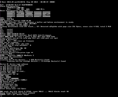

I'm trying to bootup the FRWY-LS1012A from the SD card. I followed the steps in user guide
https://www.nxp.com/docs/en/user-guide/LSDKUG_Rev21.08.pdf
section 4.1.5.4 steps 1-6 but i see the issue below. Can't get kernel Image!
What should I do to resolve this. Do i have to use special SD cards instead? I'm using Gigastone UHS-I class 10 32Gb.

Try to load your .itb file from SD to DDR at address 0x92000000 and issue the following command:
bootm 0x92000000#ls1012afrwy
Use "mmc read" command for loading your .itb file from SD.
