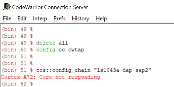

On CCS the error message I get is:
Cortex-A72: Core not responding

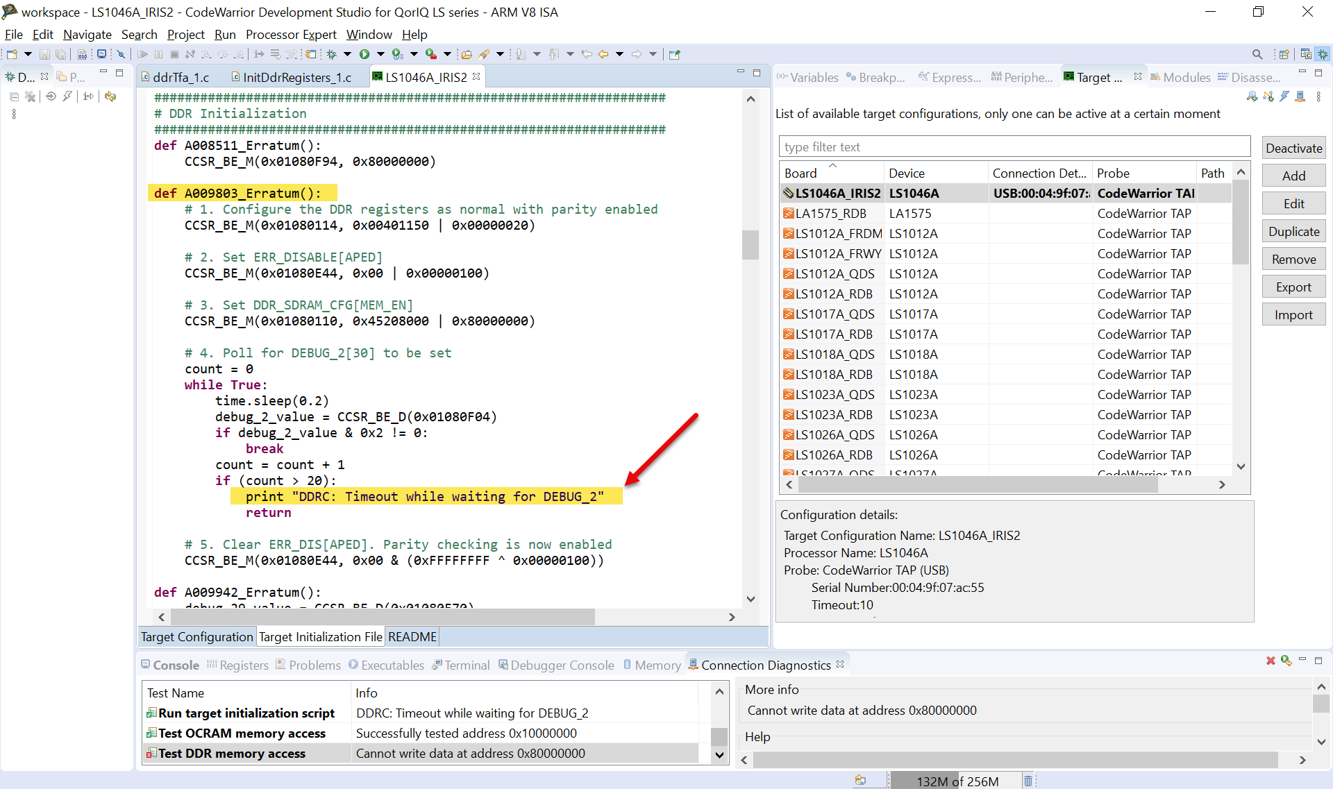

This seems to be related to the erratum A009803 as found in the target initialization file.

After rework 2 above, I am now able to induce the same failure message as seen on the bad boards. And now, I get the "Core not responding message" and I am unable to talk to the device.

1. Is there a way to bypass the DDRC init so that I can still talk to the LS1046A via JTAG to assess health status?
2. Is there a way to configure the DDRC to only talk to 3 out of 4 devices i.e. in essence ignore one or more DDR4 devices during init?
3. what are some status/error register I can look at to assess health of the LS1046A, DDRC, and DDR4 devices?
4. why does the Diagnose Connection inside the CW IDE check the marks the "Run target initialization script" step with a green checkmark, when it actually reports a Timeout? Is this the expected behaviour?

1. In target initialization File, in function "run_init_file", please comment line "Init_DDRC(DDR_freq)".
2. No this configuration.
3. Please refer to the following document.
https://community.nxp.com/t5/CodeWarrior-for-QorIQ-Knowledge/DDR-Bringing-up-and-validation-with-QCV...
4. It means there is problem with DDR controller initialization.
