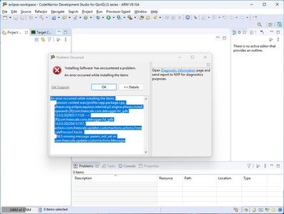

I installed CodeWarrior from CW_ARMv8_v2020.06_b200629GA_Win_Offline.exe. Once complete I check for updates, once requested all available updates to be installed it fails part way through with this error:
An error occurred while installing the items
session context was:(profile=epp.package.cpp, phase=org.eclipse.equinox.internal.p2.engine.phases.Install, operand=[R]com.freescale.core.debugger.fsl_gdb 13.0.0.202003111126 --> [R]com.freescale.core.debugger.fsl_gdb 14.0.0.202204131357, action=com.freescale.updater.customactions.actions.FreescaleProcessCheck).
NLS missing message: param_not_set in: com.freescale.updater.customactions.Messages
If I then try to install updates from com.freescale.armv8.11.5.15.E200.INT.Win.updatesite.230810.zip it takes me to a 'Install Remediation Page' (see attached image). If I go with it's recommendations it eventually returns with this error:
session context was:(profile=epp.package.cpp, phase=org.eclipse.equinox.internal.p2.engine.phases.Install, operand=null --> [R]com.freescale.core.debugger.fsl_gdb 14.0.0.202204131357, action=com.freescale.updater.customactions.actions.FreescaleProcessCheck).

Please install CW_ARMv8_v2020.06_b200629GA_Win_Offline.exe in a new path.
Then install the service pack com.freescale.armv8.11.5.15.E200.INT.Win.updatesite.230810 1.zip from Help->Install New Software->Add->Archive in CodeWarrior IDE.

NigelP
Sorry that does not work, see attached image 

yipingwang
I have verified the installation on my side, there is no problem.
Please prepare a clean installation environment.
Please install CW_ARMv8_v2020.06_b200629GA_Win_Offline.exe first.
Then open CodeWarrior IDE in a new worksapce path.

NigelP
As mentioned in one of my previous posts I'm using Windows Sandbox to test this. Windows Sandbox is a VM that provides a clean Windows 11 install to allow testing of applications in a clean environment. If it does not work in that then there is something missing as it is not dependant on anything I have on the host machine.
