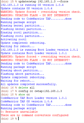

Thanks for the answer. I tried unsuccessfully:
Is there any solution to perform a factory reset ?
