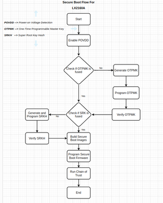

Dear NXP Team,
I am writing to seek clarification regarding the secure boot process for the LX2160A. Based on my understanding, I have outlined the secure boot flow in the attached diagram. I would like to confirm if my interpretation aligns with the expected procedure.
I have attached the flowchart for your reference. Could you please review this flowchart and confirm if this is the correct process for implementing secure boot on the LX2160A?
Additionally, if there are any steps or details that I might have missed or misinterpreted, I would greatly appreciate your guidance.
Thank you for your support and assistance.

yipingwang
During development stage, we recommend customer use CCS provided in CodeWarrior to connect to the target to write values to SRKH shadow registers.
The user needs to program image to the target board before writing SRKH.

yipingwang
Do you mean fuse OPTMK?
For development stage, please do secure boot with the following process.
  1. Enabling POVDD and only blow OTPMK to fuse array following below_OTPMK.txt.
  2. Build secure boot firmware image and deploy it to the target board.
  3. Use CCS to put the LX2160A in RSP and write SRKH in SFP mirror registers following ccs_secureboot.txt.
