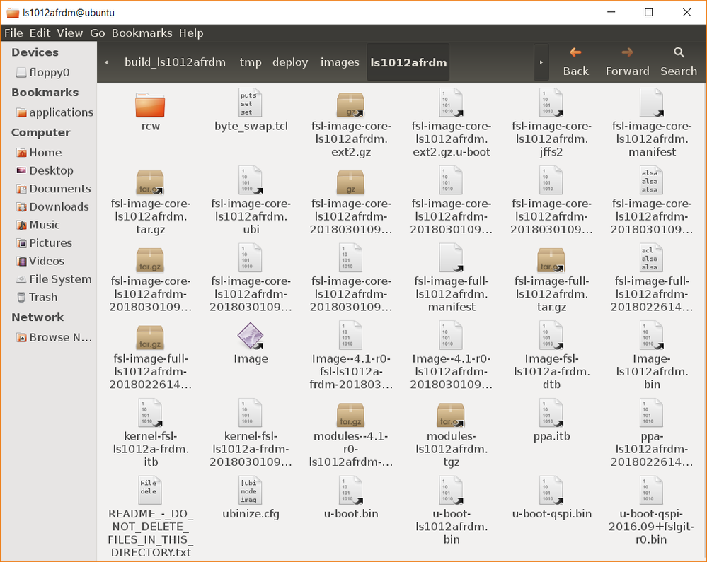

I tried to follow these steps, but it seems like I am missing some files to do so correctly. I only have an image .bin file so I used that one instead, without luck unfortunately. The files I have are listed on this screenshot:screenshot.png

You need uImage format, not Image, to load it with bootm in u-boot (or zImage if you use bootz).
uImage has a wrapper to tell u-boot how to load the binary file, created with mkimage.
Have you tried with the itb file?
