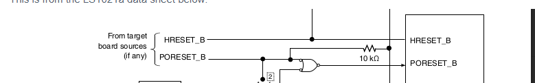

can you take a look at his regarding the JTAG/COP port is used case
This is from the LS1021a data sheet below:
                                                                                 Figure - A
                                                                                              Figure - B
                                                                            Figure - C
(1)I used a resistor R88 to connect TRST and POWER RESET Line does this
match the requirements as shown in Figure A? These two pins are then pulled up by a 10k resistor to Vcc_O1VDD, my design does not have HRESET_B pin.
(2)So as picture shows below: why there are HRESET_B and PORESET_B on the left side what source triggers them?
29,967 Views
ufedor
The R88 is OK, but you have to consider the QorIQ LS1021A Data Sheet, Table 24. RESET initialization timing specifications:
"Maximum rise/fall time of PORESET_B is 1 SYSCLKs"
29,967 Views

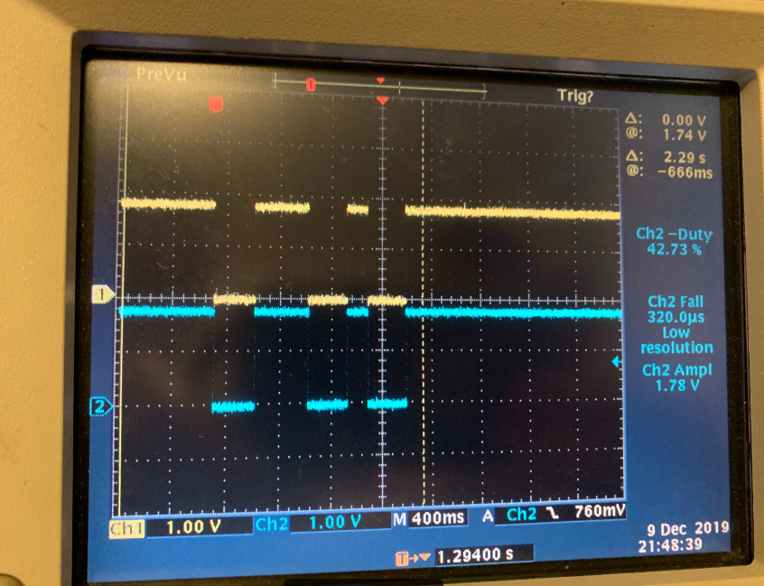

We used oscilloscope to scope the signal of JTAG_RESET and PORESET_B we found this on the eva board
The power reset gets triggered 3 times whenever you try to run the debug mode from the CW via JTAG interface.
Do I have to trigger the same sync wave forms on my atmega328p ? remember I replaced CPLD controller with atemega328p on my device
29,967 Views
ufedor
The JTAG interface must be implemented as shown in the AN4878 - LS1021A Design Checklist, Figure 32. JTAG interface connection.
The debugger asserts nRESET several timed to establish connection.
29,967 Views
