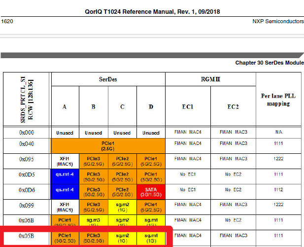

First check which SerDes lane the you are using, please confirm the SerDes land in the QorIQ T1024 Reference Manual. Such as configuration below, the user case set the SRDS_PRCTL_S1=0x05B in the RCW[128:136], the application will utilize the SGMII.m1 and SGMII.m2.
This article will consider SGMII.m1 as an user case, now the SGMII will in the Frame Manager, MAC1.

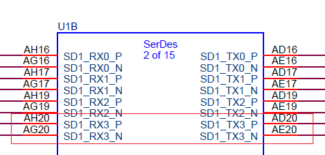

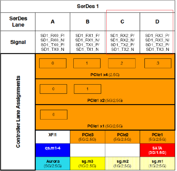

Check the SerDes Lane Assignments to confirm the Lane of the SerDes, for the SGMII.m1, the specific lane pins name would be SD1_TX3P/N and SD1_RX3P/N. it could be recognized as Lane 3.
MAC number is not related to the Serdes lane number, should confirm the specific table to get the pins.
Any hardware test with this ethernet should related the pins, see the component pin number below.

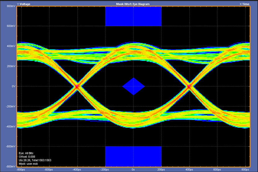

You could test the eye diagram of RX pins of this Lane to confirm if the frequency is correct. if you set this Lane to SGMII 1.25G, you could confirm the speed is set correctly by the eye diagram.
Eye diagram above, just show the speed of the SerDes.
That is very important when loopback correctly, but could to connect to other device.

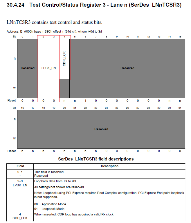

SerDes_LNnTCSR3 is an important debug test register, the CDR_LCK is to check if the CDR locked or not.
CDR_LCK=0 means a valid bit stream is not detected. As a test, you could put the lane in loopback mode LN2TCSR3[LPBK_EN]=01. The CDR should lock in digital loopback mode (internal loopback). If not, there could be an issue with the device itself.
So, if you could set the LPBK-EN to “01” Loopback Mode, it will set the SerDes’s own TX and RX signals in Loopback Mode to exclude external signals, then check the CDR_LCK again, if it’s 1, then SerDes itself works well. Anyway, CDR_LCK should always be set.
In the “md.l 0xFFE0EA8FC 1 - 04000000 # LN3TCSR3”, the CDR_LCK=0, suspect the SerDes level issue.
The normal status should be:

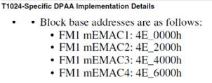

For the SGMII MAC address should be offset+0x1000.
Follow the 6.5.4 MDIO Ethernet Management Interface usage in the T1024DPAARM to read the MDIO registers.
In this application, SGMII1, MAC1, you could find the MAC1 address would be FM1_mEMAC1: 4E_0000, so FM1_mEMAC1 MDIO registers would be 4E_1000h.

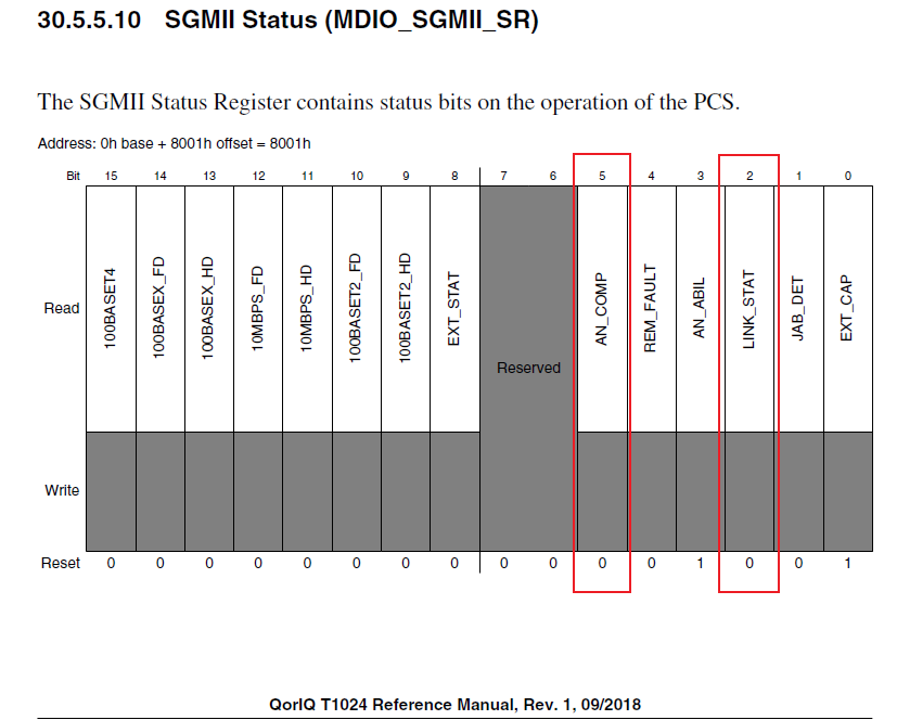

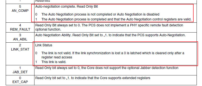

In this user case, should read the MDIO_SGMII_SR, you could find the register definition in the QorIQ T1024 Reference Manual, 30.5.5 1000Base-KX PCS MDIO Memory Map/Register Definition
The key bits would below:
Here the user case result:
When you read MDIO_SGMII_SR, please use manual input that can meet the delay time requirement.
If you could not input manually, please follow the flow, " Wait for MDIO_CFG[BSY] = 0" before read MDIO_DATA value.

The first time, it’s not link, LINK_STAT is 0(0x00000029), and then it’s turn to 1(0x0000002D).
Now the PCS link up and the HW loopback checking is completely.
