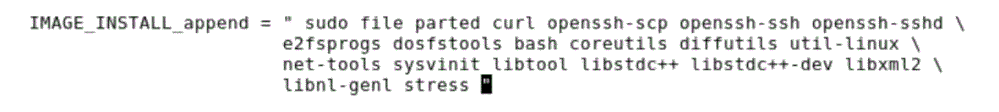

  4. Add “stress” package to "IMAGE_INSTALL_append" parameter of local_arm64_tiny.conf file available in flexbuild_<version>/configs/yocto/ folder.Package.GIF
  5. Save and exit the file.

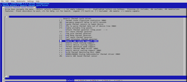

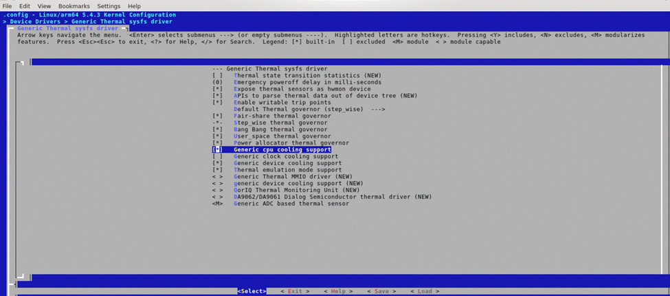

  4. Navigate to Device Drivers --> <*> Generic Thermal sysfs driver --> [ ] Generic CPU cooling support option.
  5. Press Y key to include the option. [*] symbol indicates the option is included (shown in below figure).

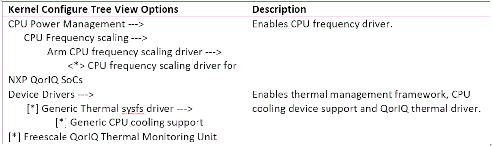

  6. Similarly, include the following options to enable thermal management framework.
  7. After you include all options as mentioned in the above table, save the configuration with a file name. For example,  save the configuration file as thermal.config.

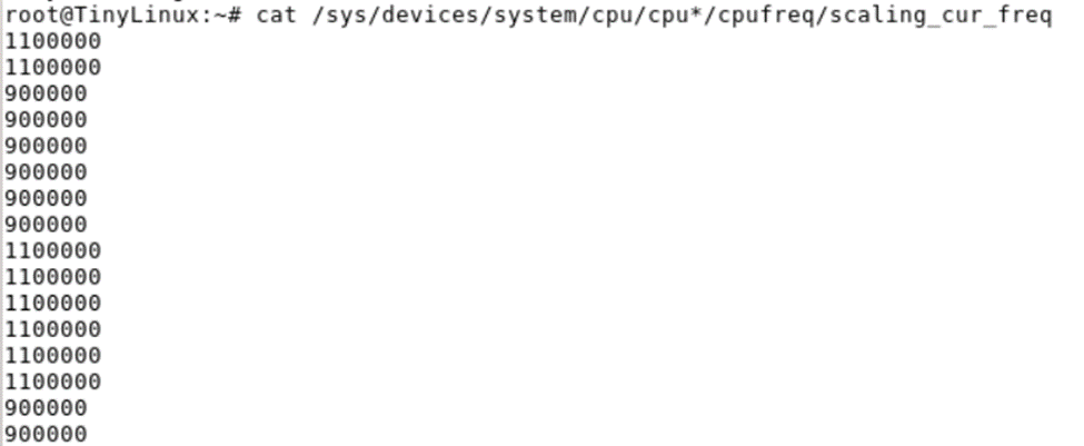

  2. Check scaling_current_frequency of the cores.
    # cat /sys/devices/system/cpu/cpu*/cpufreq/scaling_cur_freq
     For example: Check frequency of 16 cores of LX2160ARDB as follows:temp validate-1.gif

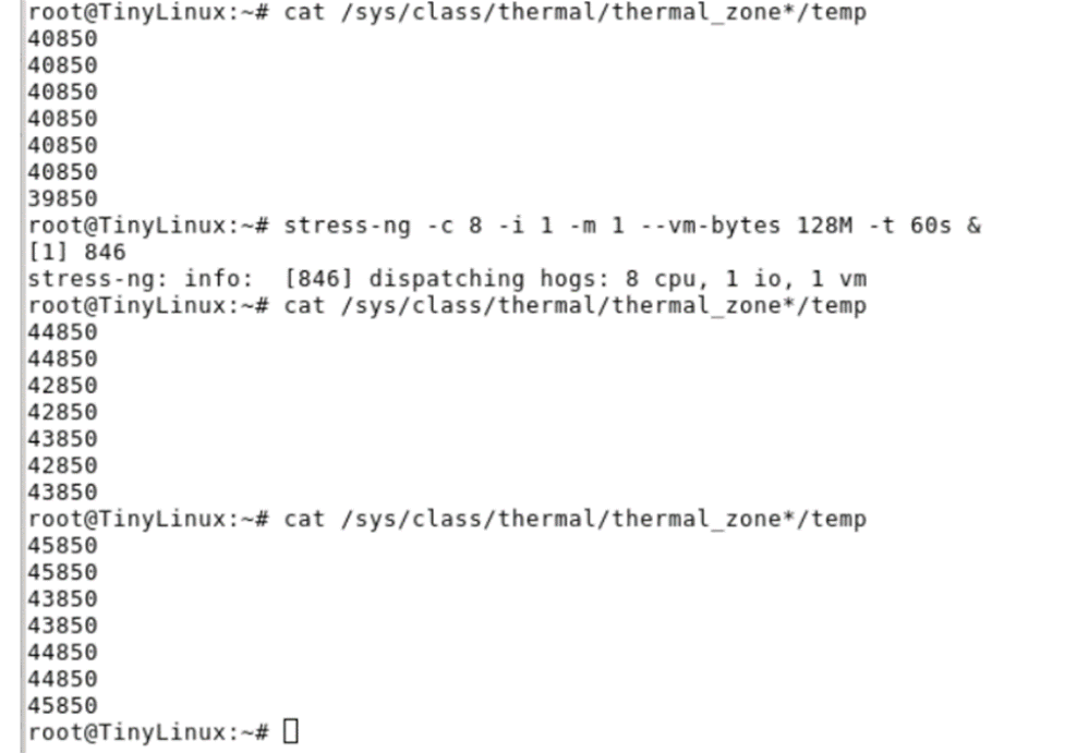

  3. Check the temperature of the CPU before applying stress.
    # cat /sys/class/thermal/thermal_zone*/temp
  4. Apply stress by executing following command:
    # stress-ng -c 8 -i 1 -m 1 --vm-bytes 128M -t 60s &
    The command applies stress for 60 seconds. For more information on stress-ng command, run stress-ng -h command for help.
  5. Check the temperature of the CPU after applying stress.
  6. # cat /sys/class/thermal/thermal_zone*/temp
    For example:
