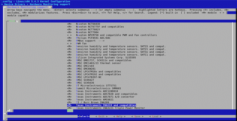

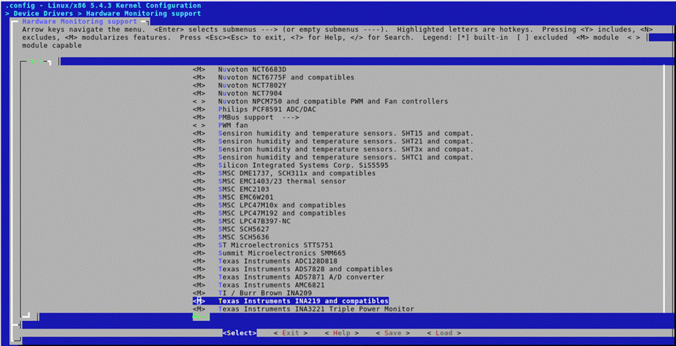

  4. Navigate to Device Drivers --> <*> Hardware Monitoring Support --> [M] Texas Instruments INA219 and compatibles option.
    Device Drivers-->Hardware Monitoring SupportDevice Drivers-->Hardware Monitoring Support
  5. Press Y key to include the option. [*] symbol indicates the option is included (shown in below figure). This enables INA220.
    Texas Instruments INA219 and Compatibles option includedTexas Instruments INA219 and Compatibles option included

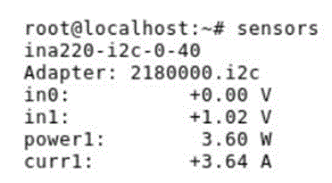

  2. Measure CPU power before applying stress to the cores.
    $ sensors
    CPU power before stressCPU power before stress

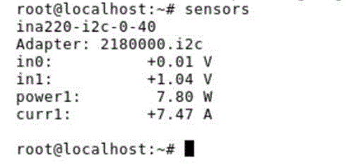

  3. Apply stress to CPU cores using the following command.
    # stress -c <number of cores> -i <number of IO> -m <number of vm> --vm-bytes 128M -t <time in seconds> &
    For example:
    The command applies stress for 60 seconds. For more information on stress command, run stress-h command for help.
  4. Measure CPU power after applying stress in given time interval.
$ sensors
