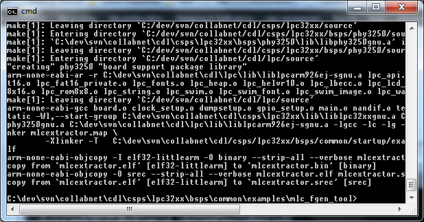

First, open a Windows 'cmd' shell and switch to the CDL directory. Use the "setenv" command to setup the environment for build. Note the 2nd parameter (board) doesn't matter, so we'll use "ohy3250". The 3rd parameter is the toolchain which will be ""gnu". The 4rth parameter is "1", indicating verbose output.
Switch to the mlc_fgen_tool directory and type "make". If the tools are installed and everything is setup correctly, the tool will build and you will get a "mlcextractor.bin" file that can be used with the serial loader tool.
