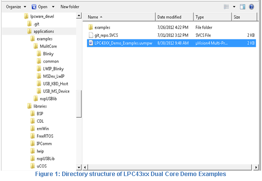

The software has two main directories, the “library” directory and the “applications” directory. It follows the same directory structure as followed by the “NXPUSBLibrary”. Inside the “applications” directory is the main Keil multi project workspace LPC43xx_Demo_Examples.uvmpw could be found as shown in Figure 1: Directory structure of LPC43xx Dual Core Demo Examples. The library directory has the following libraries[1] in it
  • CDL (for LPC43XX)
  • BSP (for KEIL MCB4357 board)
  • nxpUSBLib (for Host and Device)
  • FreeRTOS
  • IPComm
The example directory will have both the nxpUSBlib, and the MultiCore examples. This document will only have the details about the MultiCore examples. The Following MultiCore examples can be found under examples directory.
  • Common (Not an example in itself but is used by all the examples)
  • USB_KBD_HostBlinky)
  • USB_MS_Device (USB Mass Storage device and Blinky)

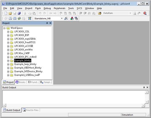

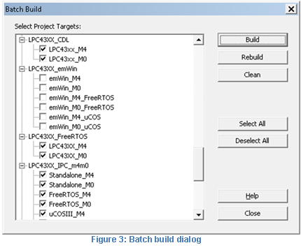

Open the Keil uVision multiple project workspace by double clicking on the “LPC43xx_Demo_Examples.uvmpw”. The project workspace opens in the uVision IDE, as shown in Figure 2: LPC43xx_Demo_Example in Keil uVision Workspace.
For building the libraries it is recommended to use the batch build option provided by Keil. Select “Project” from the menu (on top of the IDE), followed by “Batch build…”, which will open the batch build window as shown in Figure 3: Batch build dialog. To build a specific library all the other selections must be cleared, this can be done by clicking on “Deselect All” button located in the left side of the dialog. Now to build, say CDL library, the appropriate library configurations must be selected [Example, for CDL “LPC43xx_M4 and LPC43xx_M0” must be selected]. Clicking the build button located at the top left side of the dialog will build the selected library. Each project is provided with a README.TXT file that will help the user to know more about the various configurations and how to use them.
The library can also be built configuration by configuration. To do so, one must first make that project active by right clicking on the library and selecting the “Set as Active Project” from the menu that pops up (marked red in Figure 4: Setting active Project and Configuration), now select a configuration from the pull down menu (marked as green in Figure 4: Setting active Project and Configuration). Once the active configuration is selected press “F7” key to start the build process of the active configuration. After successful build select the next configuration and start the build process.

For batch building this library it is recommended to select all the configurations.

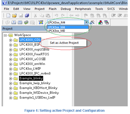

  1. Select the example as active project by right clicking on it (Circled red in Figure 4: Setting active Project and Configuration)
  2. Select the M4 configuration from the configuration selection pull down menu (Circled green in Figure 4: Setting active Project and Configuration)
  3. In the project view (Located in the left side of the IDE), expand the active example by clicking on it and click on the configuration (shown with a folder icon)

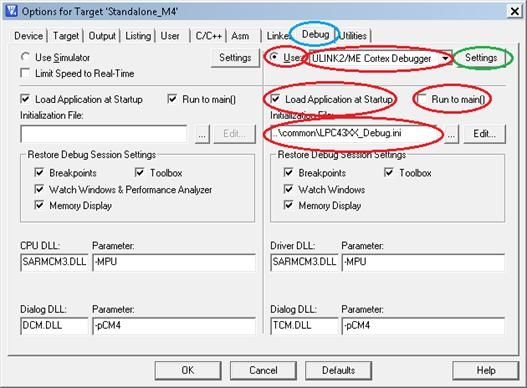

  4. Press “Alt” key and while holding it Press and release “F7” key, this will show the options dialog for the currently selected M4 configurationimage006.jpg

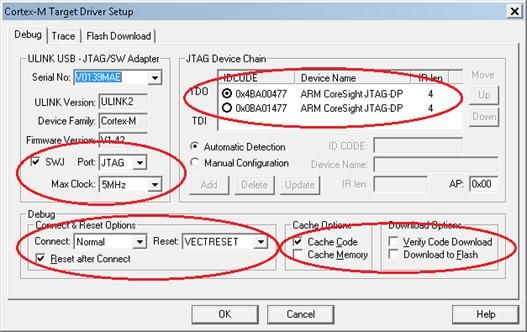

  5. 6.     Now configure your debugger as shown in the figure (Red circles in Figure 5: Debugger configuration in Keil uVision)5.     Click on the “Debug” tab located on the top of the dialog (Blue circle in Figure 5: Debugger configuration in Keil uVision)
  6. Click on the Settings button (Green circle in Figure 5: Debugger configuration in Keil uVision) to open the debugger hardware configuration dialog as shown in Figure 7: U-Link debugger Hardware settings
  7. Setup the configuration[3] (shown in red circles) in the dialog as shown in Figure 6: U-Link debugger Hardware settings

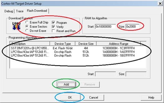

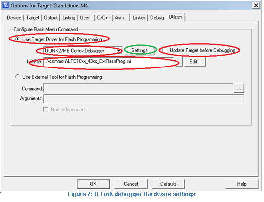

  9. 10.  Now click on the utilities tab at the top of the options dialog (Tab next to the blue circled debug tab in Figure 5: Debugger configuration in Keil uVision)image010.png
  10. Now the window will look as shown in Figure 7: Keil flash configuration utility window
  11. Setup the configuration (red circled) in the utility window as shown in Figure 7: Keil flash configuration utility window
  12. Click the settings button (Green circled in Figure 7: Keil flash configuration utility window)
  13. That will open the Flash driver setup window as shown in Figure 8
  15. Click on the add button (Green Circled in Figure 8: Flash driver configuration window)

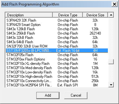

  16. That will open the flash programming algorithm select window as in Figure 9: Flash Programming Algorighm select window
  17. In the flash programming algorithm window select SST39VF3201x[4] and click “Add” button in Figure 9: Flash Programming Algorighm select window
  18. Repeat Step 16 to 18 for LPC18xx/43xx IAP 512kB for both 1A000000 and 1B000000 address range
  19. Click OK (Blue circled) as shown in Figure 8: Flash driver configuration window
  20. Press OK in Keil flash configuration utility window to save the configuration and exit the options window
  21. Repeat the steps for all the examples for all the M4 configurations                                                               image013.png
