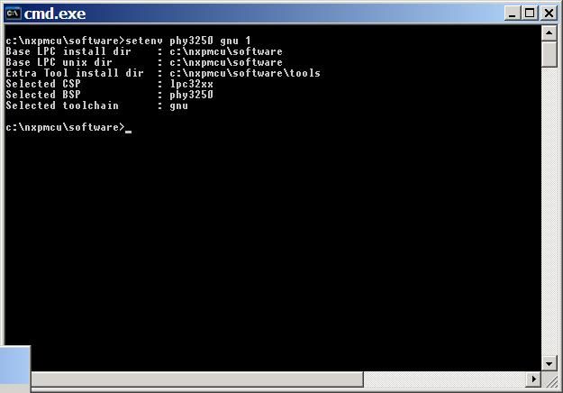

Building the burners, kickstart loader, and S1L
Make sure you have the CodeSourcery Lite GNU tools installed and that you can run them from a CMD shell in Windows.
Download and install the LPC32x0 v2.01 CDL and navigate to the 'software' directory in a CMD shell window. If you are usnig the Phytec board, type 'setenv phy3250 gnu 1' to setup the build system for the Phytec board. FDI board developers should use 'setenv fdi3250 gnu 1'. See below for the Phytec setup.
You need to build 4 programs - the kickstart burner, S1L burner, kickstart loader, and S1L (from kick full) application.
To build the programs, type 'make' in the following directories in the CDL.
