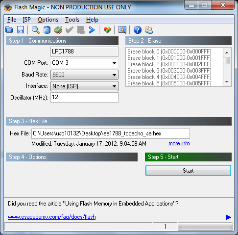

Then type make to build the project. If your project builds without errors, you should get a hex file that can be programmed into the board usng the Flash Magic tool.

Once the image has been built, you can use Flash Magic to program the image into internal FLASH using the generated HEX file.
