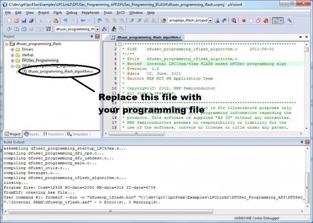

Building the programming algorithm
The currently available pre-configured projects for building the programming algorithms are only available for the Keil uVision4 toolchain. To build the project with your driver, open one of the pre-configured projects and replace the file under the DFUSec_programming_algorithm group with the new driver. Click build to compile and link the image. The final result of the build cycle will be a binary image with a .bin extension.
