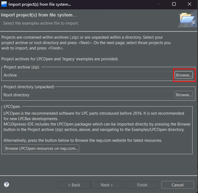

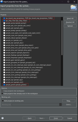

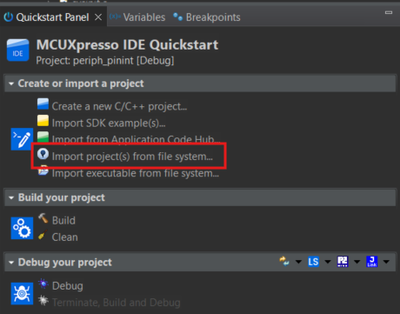

I wasn't able to follow the entire configuration because I couldn't find the definition for LPC_GPIO_PORT. However, I recommend checking the periph_pinint example, which configures a pin interrupt triggered by a falling edge.
You can find this example in MCUXpresso by following these steps:
Quickstart Panel -> Create or import project -> Import project(s) from file system.
Project archive (zip) -> Browse -> LPCOpen -> lpcxpresso_1549
Select lpc_board_nxp_lpcxpresso_1549, lpc_chip_15xx and periph_pint
Pablo
