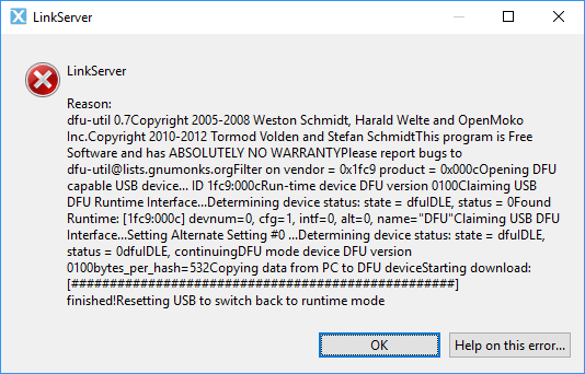

I've bought two LPClink2 boards but I can't debug a board with LPC114 using them. When I start to debug
with LPCXpresso (8.2.2) in first a windows notify me that:
Initializing link server with LPC432x_CMSIS_DAP_V5_173.bin.hdr
after some time, the result is :
Timeout waiting LinkServer to initialize(0)
and if I abort and see log error message, the end of message is :
finished! Resetting USB to switch back to runtime mode
That is seems that it download correctly the firmware and can't reset the board. Anyone experienced this ?

Hello everybody. I had the very same problem right now. OS is windows 10, LPC-Link 2 enumerates but linkserver doesn't start with similar error message. I've made it work somehow. Strangely enough, there was some kind of conflict with the transmitter of wireless mouse. So, the sequence of actions in my case was the following:
1. Unplug the mouse transmitter.
2. Execute "C:\nxp\LPCXpresso_8.2.2_650\lpcxpresso\bin>boot_link2". It replies with "LPC-Link2 booted" message.
3. Plug the mouse transmitter back.
Now LPCXPresso works normally with the debugger.

francescocuzzoc
there are news regarding ?
regards
4,285 Views
francescocuzzoc
here is the window
4,285 Views
