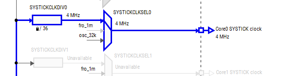

R3t0
Thanks for the explanation of the SysTick_Config() function. In the Clock Config Tools, the Systick Clock can also be set, what is the connection to the SysTick_Config() function here?
