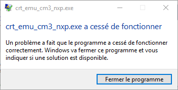

Content originally posted in LPCWare by lquinet on Sun Feb 28 08:39:02 MST 2016
I've been using LPC-LINK with LPC1769. I've been using LPCXpresso version 7.9.2_493 to program the device, but the problem is when I want to debug or to program the flash. The LPC-Link probe v1.3 is recognized but it seems that it can't be able to communicate with the device. I sometimes have the error message "crt_emu_cm3_nxp.exe has stopped working", but always the error message "Command failed with exit code - 1073741819".
The state given at the end is:
Ni: LPCXpresso Debug Driver v7.9 (Aug 11 2015 15:47:24 - crt_emu_cm3_nxp.exe build 262)
Pc: (  0) Reading remote configuration
Pc: (  5) Remote configuration complete
Pc: ( 30) Emulator Connected
Xw:
Xc:
Pc: ( 40) Debug Halt
Pc: ( 50) CPU ID
Nc: Emu(0): Connected&Reset. CpuID: 410FC230. Info: WIN64HS12
Nc: Debug protocol: SWD Frequency 250 KHz. RTCK: Disabled. Vector catch: Disabled.
Nc: loaded v.2 On-chip Flash Memory C:\nxp\LPCXpresso_7.9.2_493\lpcxpresso\bin\Flash\LPC175x_6x_512.cfx
Nc: image 'LPC175x_6x (512K) Aug 11 2015 16:53:22'
Nc: NXP: LPC1769  Part ID: 0x00000000
Pc: ( 65) Chip Setup Complete
My OS is Windows 10 64 bits and my laptop is an Asus X555LJ.
I have also been try with and other board and another version of LPCXpresso (LPCXpresso_8.0.0_526). I also reinstall the software and the drivers, without success.
Thanks a lot for any help.

Thank you for the attachments. The short story is the crt_emu_cm3_nxp debug utility is crashing. I can't say why this happens given it has been working earlier. I realize you've replicated the problem with LPCXpresso 8.0, but I'll recommend you uninstall the LPCXpresso installations on your computer, and also the LPC-Link1 and LPC-Link2 device drivers. Then, install the latest release, LPCXpresso 8.1.2, and let us know how you get on.

Sorry I thought it was clear. The flash programming or the erasing of the flash doesn't work. I took captures of the error message.
Then I edited my project launch configuration as you asked me. I captured the debug errors, too.
The problem come from the killing of "crt_emu_cm3_nxp.exe" by windows when I want to debug I think, but I don't understand why it kills the program.
Thanks a lot for your help.
